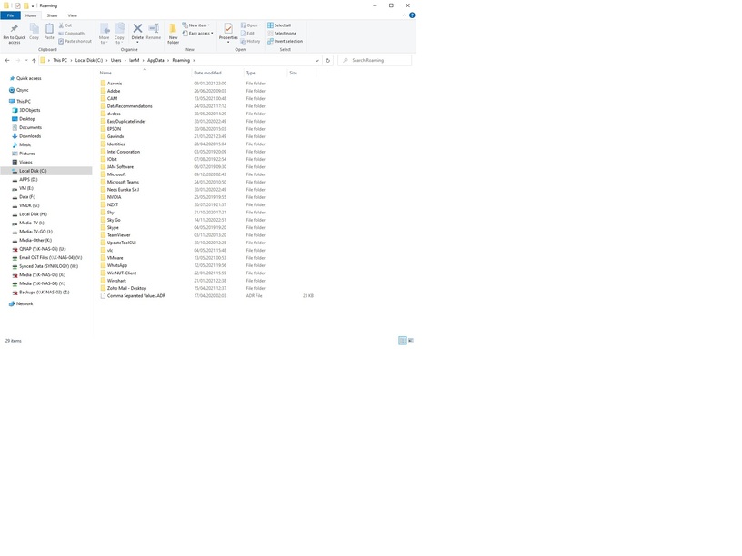

Shows that there is no Plex folder created under APPDATA\Local or APPDATA\Roaming
As for the data directory… please check for the Plex Media Server folder in C:\Users\IanM\AppData\Local (not Roaming).
If it’s not even getting to produce that folder (incl. some basic logs), your next step should be doing a full uninstall incl. all related settings (incl. Registry) to rule out there’s something stuck
