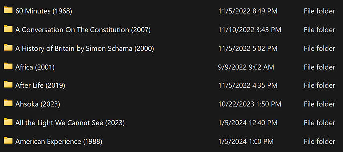

Please show how you have the files named and organized. Include the full path to the files and their extension. A directory listing, screen shot from File Station, etc. See example below.

Files are formatted correctly and using the same formatting example you provided. I use TMM for all files.

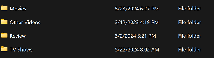

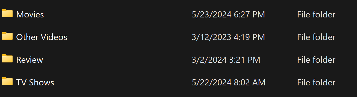

I believe my file tree is set up correctly. Of the folders below, “Review” is not a Plex folder.
All folders and files are properly formatted using Tiny Media Manager:
