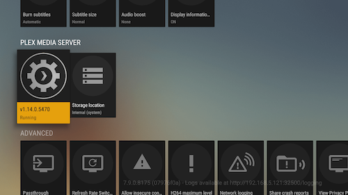

check shield plex client settings - can you find setting for plex server
Shield-Server-Status-small
