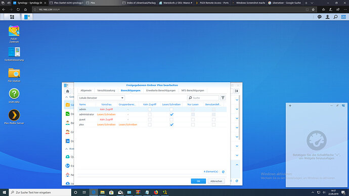

Please do the following:
  1. Control Panel - Shared Folders - EDIT the Plex share
  2. Permissions
  3. Give your username *R/W permission
  4. Open FileStation
  5. Navigate Plex/Library/Application Support/Plex Media Server
  6. Right - Click Logs
  7. Compress to Logs.zip
  8. Download and attach the ZIP file here please.
Logs (3).zip (2.4 MB)

Please verify user Plex can R/W the Plex share.
This will also mean:
