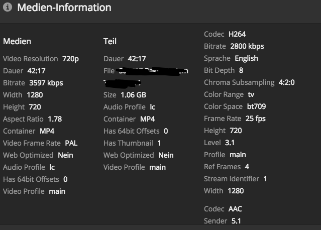

Hier bitteschön.

Optimiere mal die mp4 Datei für Streaming.
Geht z.B. mit mp3tag
Ordner mit der Datei aufrufen, dann Rechtsklick auf die Datei, 3. Menüpunkt von unten
Danach die Datei neu von Plex analysieren lassen

Probiere mal was Otto geschrieben hat.
Grund:
You can see the browser makes 3 requests before it can start playing the video. In the first request, the browser downloads the first 552 KB of the video using an HTTP range request. We can tell this by the 206 Partial Content HTTP response code, and by digging in and looking at the request headers. However the moov atom is not there so the browser cannot start to play the video. Next, the browser requests the final 21 KB of the video file using another range request. This does contain the moov atom, telling the browser where the video and audio streams start. Finally, the browser makes a third and final request to get the audio/video data and can start to play the video. This has wasted over half a megabyte of bandwidth and delayed the start of the video by 210 ms! Simply because the browser couldn’t find the moov Atom
https://rigor.com/blog/2016/01/optimizing-mp4-video-for-fast-streaming
