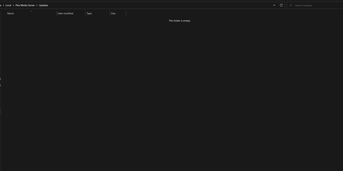

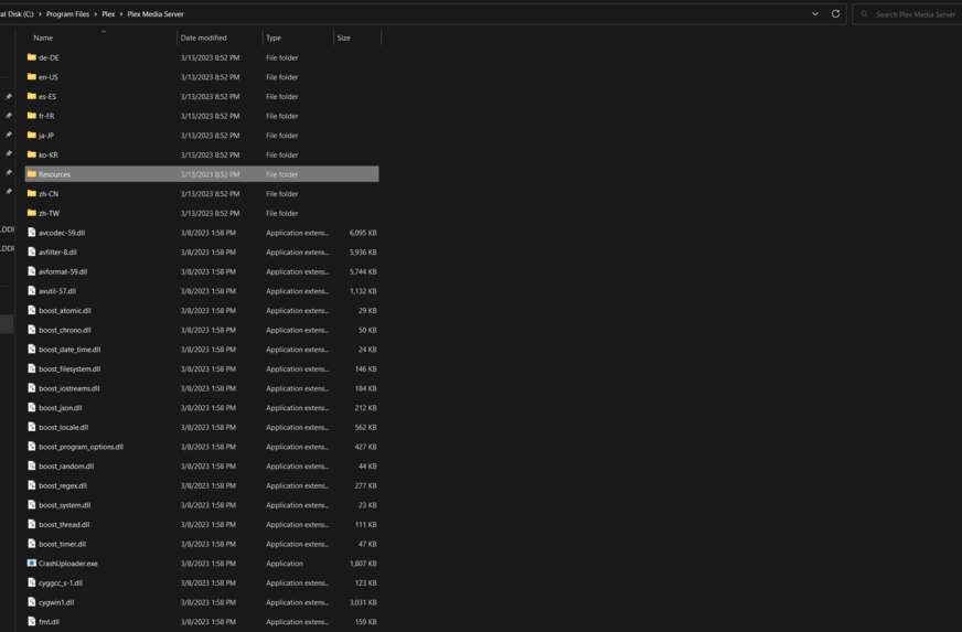

Take a look into your Plex data folder. See if you have a subfolder named Updates in there.
It should contain older versions of the plex server installer.
Uninstall Plex server (make sure to NOT use any “uninstaller” software or CCleaner or similar apps!)
install the older version
try again to claim the server
I don’t have any subfolder named updates.
This is not the plex data folder. This is the Plex program folder.
My bad,
It’s empty. I tried last week something, I downloaded an older version directly from plex website, but I encountered same problem
