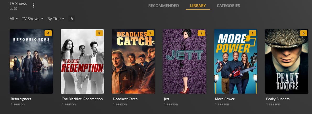

What did you set the library type to, and what agent/scanner is being used?
uhmm, all that info is in first post :wink:
Can you take a look at your advanced section of your library (you noted the scanner but not the agent) and make sure it matches this:
Untitled
yes, everything default. you can not change plex tv series agent w/o changing scanner anyways
Im at a loss here, the logs dont have anything useful, and I cant re-produce the issue. When I load those files into my test plex it works just fine.
