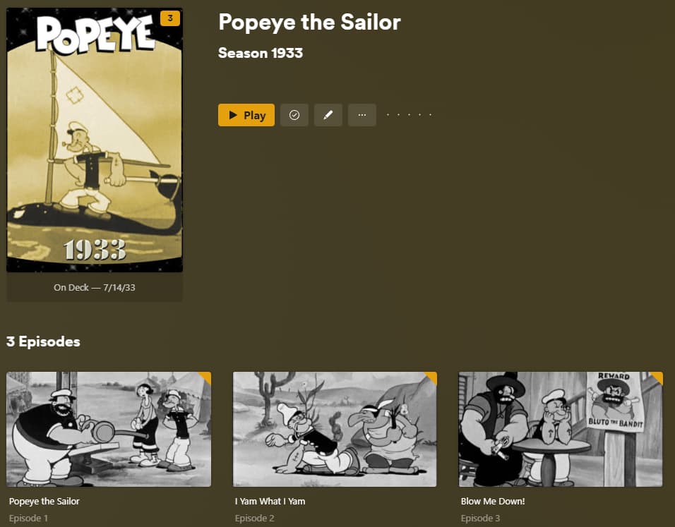

FYI, just checked and Popeye (1933) now working correctly.
M:\...\TEST-TV
└───Popeye the Sailor (1933) {tvdb-78435}
    └───Season 1933
            Popeye the Sailor (1933) s1933e01.mkv
            Popeye the Sailor (1933) s1933e02.mkv
            Popeye the Sailor (1933) s1933e03.mkv
Thank you, it looks good 2 me
