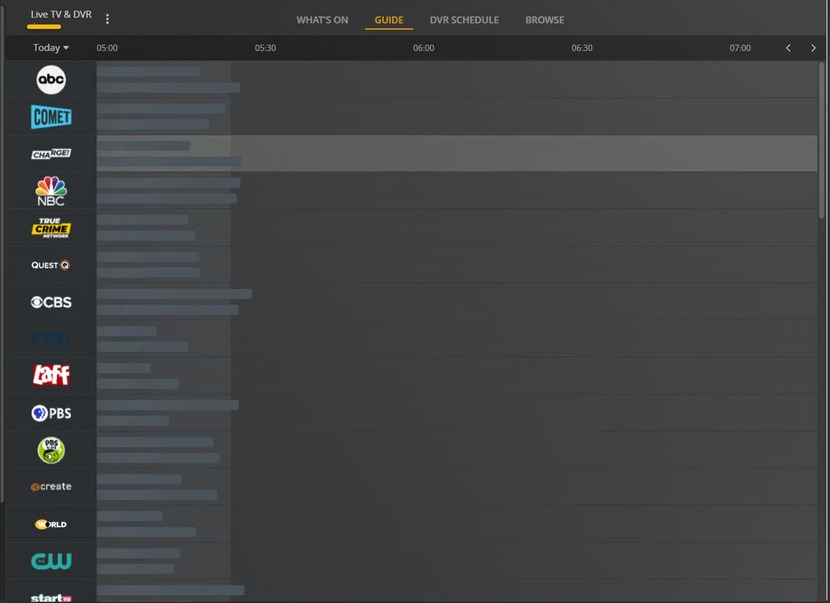

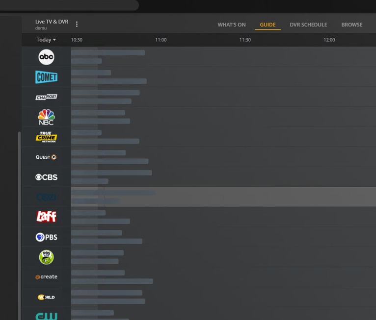

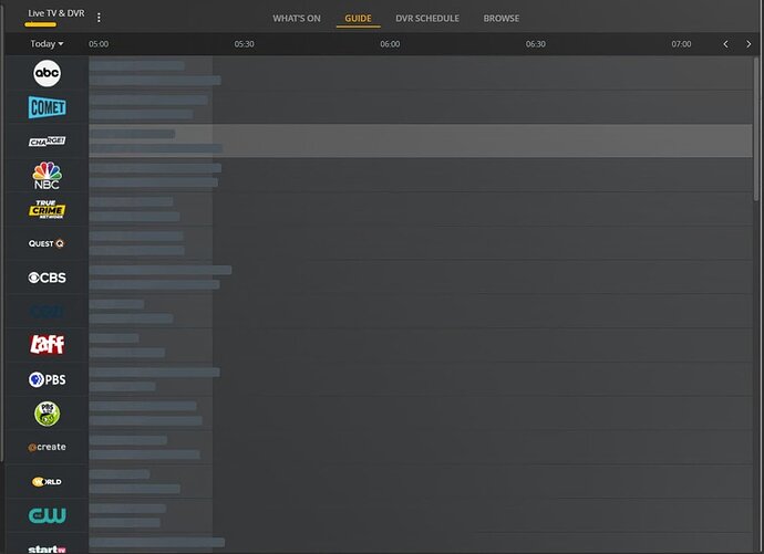

My DVR on Windows 10 stopped recording a couple of days ago and when I try to look at the guide, on the local box or another computer this is what I see:
I have tried the following:
  • Refresh guide.

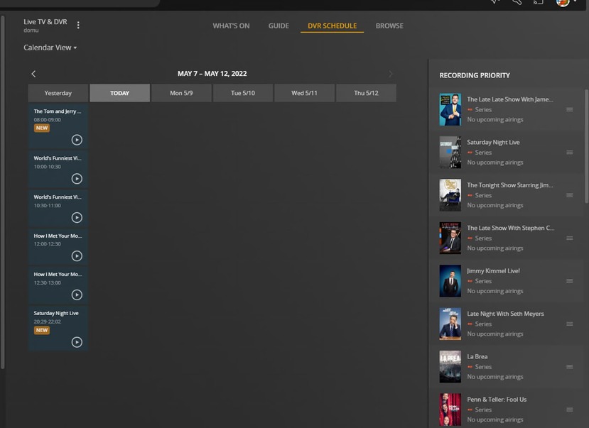

What else do I have to do to get the DVR to show me what is on the channels and to start recording shows agin. This next image shows that there are no ‘upcoming’ recordings
But you can see that my NVidia Shield shows that the Tonight Show and Colbert have an upcoming episode

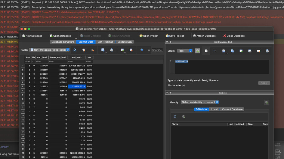

i downloaded a sql lite db ‘browser’ for a quick peak. This is what is in the table that appears to be in question.
Is there a ‘reset’ / ‘clean’ option I can do, since ‘optimize database’ didn’t seem to fix anything?

Thanks @hokierulz , I was on a similar track and it appears to have been fixed. You can see from this screen shot that whatever want awry it looks like it was inserting duplicate info so it might have been violating a PK constraint on the db.
For any future people who have a similar issue (on Windows) I:
  • Deleted the DVR.
  • Exited the Server app in the Windows toolbar.
  • Ran ‘repair’ a couple of times.
    ** Problem is, it looks like the repair initialized tables and applied permissions. Didn’t actually ‘repair’ any unexpected (bad) data.
  • Started the server application and gave it a minute to warm up.
  • Add the DVR and let the guide fully refresh. Even gave it a couple of minutes after it started showing items in the guide.

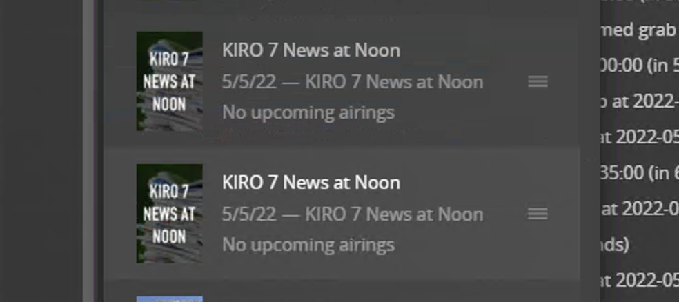

  • Clicked to the DVR SCHEDULE and noticed duplicate entries; I deleted the entry showing ‘no upcoming airings’
  • Scheduled a couple of new recordings - 1 ‘now’ or within the next 15 min and also one with an ‘All Episodes’ selected, starting somewhat soon.
 so far, everything seems to be OK.
Thanks again for the trouble shooting hokierulz.
