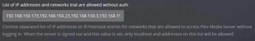

Where can I find that setting? I looked but could not find it.
That setting got superseded. Authentication is default. There is this setting to whitelist local subnet and local IPs not requiring authentication
List of IP addresses and networks that are allowed without auth
See https://support.plex.tv/articles/200430283-network/
I added some IP address to my Plex server but how can I add a range of addresses? For example 192.168.150.1 to 192.168.150.10?
it would be individual ip addresses coma separated (and no spaces) or defining a range with use of netmask
so 192.168.150.1/255.255.255.0 or 192.168.150.1/24 would include the whole class c subnet
There are many web sites that explain netmask values - there is a table here which shows number hosts for different netmask values
http://www.unixwiz.net/techtips/netmask-ref.html

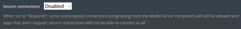

Remember that on its own will not be sufficient, If you have not disabled secure connections there will be requirement for DNS access which needs internet
When disabling secure connections on the server,. see if the client app has a setting to allow fallback to insecure connections and adjust that
Configurations changed.
Secure connections
IP range allowed without authorization. (my entire home network)

Secure Connections
This is dependent on plex.tv for finding the secure url to use and also dependent on DNS to be available to convert the url to an IP Address.
So first is to disable secure connections in server network settings.
If you are unable to connect to the server setting to make the change because of need to authenticate, you can edit the server settings manually
Edit or Add setting secureConnections and set the value to be 2
Plex client apps by default are set to use secure connections and not to fallback to insecure connections. So check the application settings and look for a setting for Fallback to insecure connections - change it to Always
