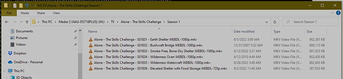

example1: tv show “Alone - The Skills Challenge”
here you can see 6 files, plex will not see episode 1 “earth shelter” (See next screenshot)

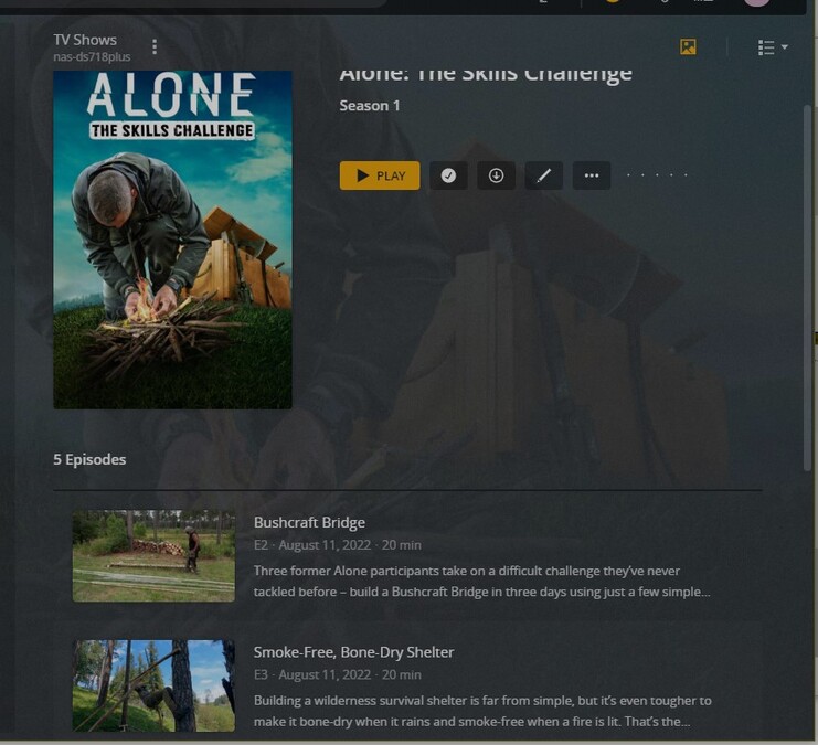

as you can see plex only sees 5 episodes. and no amount of rescanning the library fixes it. i am required to do the plex dance to get plex to see episode 1.
