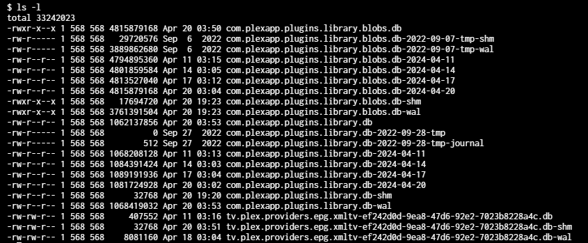

Logs
@mattdeezly1996
would you please, in a terminal window, make a tar.gz of the “Logs” directory and attach it?
Also please show me a ls -lah of the ‘Databases’ directory ?

Here is the Databases directory.

Seeing the journal file in the Databases directory was all I needed to see to confirm it’s mid-transaction.

Do you see file sizes or dates/time stamps changing ?

As for checking on the files dates/time stamps, “com.plexapp.plugins.library.blobs.dl-shm and -wal” are updating
