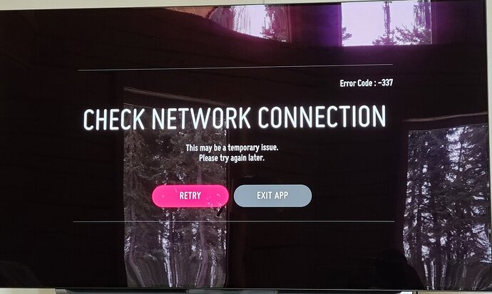

Plex wont work with familys tv,lg web os
It does seem to me to be an error output at the TV OS level..but the TV displays NO network issues with anything else (youtube, netflix etc.) and no other device on my network has plex connection issues. Also, if I use the TV to stream anything through DNLA from the same Plex server it works perfectly.
I seem to get these in the console when the -337 is displayed:

That is an LG error. We have no control over that.
That first Plex message is harmless, it just means that a Plex device couldn’t be found. This is used for identifying other players so you can use one Plex client to send playback to another Plex client.
That second error is a result of the loss of network connection, not a cause so that would be expected to see if the TV losses connection.
I my experience. I’ve seen lots of issues with the WiFi on LG TVs. Not sure if it’s an interference issue or just a bad WiFi card on the TV. I get that from time to time on my own TV, even when not using Plex. If possible, use the wired connection. That works much better.
I get that the LG OS is putting out the error…but I have NEVER seen that error on my TV except when using the LG Plex app. It ONLY shows up when when using the LG Plex app and streaming from the same Plex server via DNLA never has a similar issue. Also, a few PMS versions ago I never got this error. It is new.
It is clearly triggered by something in the Plex app. The plex app won’t even load and go to the home screen most of the time…it just displays the plex logo for 30 seconds or so and then goes to this screen. All other apps works flawlessly…ALL THE TIME.
It’s not a TV wifi issue or it would be displayed just as often using netflix, youtube or any other network reliant app etc…or streaming from the same server via DNLA but it NEVER does…not once.
It’s not an interference issue. I live in a remote area and I’m the only wifi signal around.
I ran an Ethernet cord to the TV. Still got that same -337 error screen…all other apps work fine…DNLA works fine.
It’s like the Plex app crashes the TV network driver or something like that. It doesn’t act like there’s an actual network issue. Or maybe PMS doesn’t recognize that its asking for data?

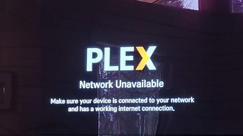

If the TV is offline (intentionally I disconnected from the network) this is what you get:
If I take my Plex server offline then I get the -337 page on the LG Plex app.
