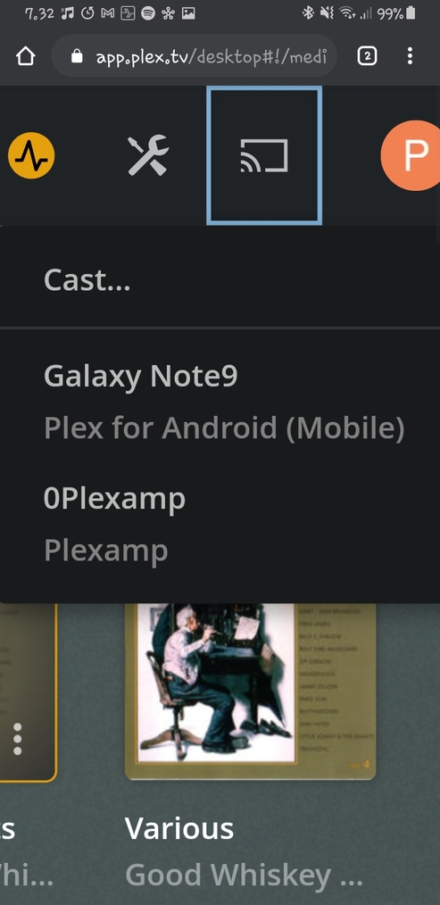

I think that they indeed turned casting to plexamp off because earlier I was able to cast from plexamp 3.x to plexamp 2.0 on raspberry pi4. Then after an update plexamp can’t find older plexamp on raspberry that used to work before. Although plexapp on android and web interface can still cast to plexamp 2.0 on raspberry. Others seem to have the same problem.

Being unable to control Plexamp 2 seems like a bug. Could you provide some more details of what’s happening there?
I don’t know whats going on I’ve done fresh installs on all hardware but the server and it’s not working. Used to work about a month ago but not anymore thus I thought casting to any plexamp type player was disabled with an update. Oh and in the screenshots 0Plexamp is the pi one.
I also have 5 wall mounted android tablets that all used to work but now show the same symptoms as my phone. I have one tablet that is not used so often and mostly off and thus plexamp version/settings are older on boot.
Week ago I booted it and at first plexamp on it showed plexamp on the pi as a castable device but in few seconds it just disappeared. I quess settings or app version got updated after boot and the problem started.

Forgive me if you’ve already tried this, but it looks like the list of “castable” devices in Plexamp is truncated. The symptom of the device appearing and disappearing quickly lines up with the behaviour of the list populating. Have you tried scrolling down inside the cast dialog?
