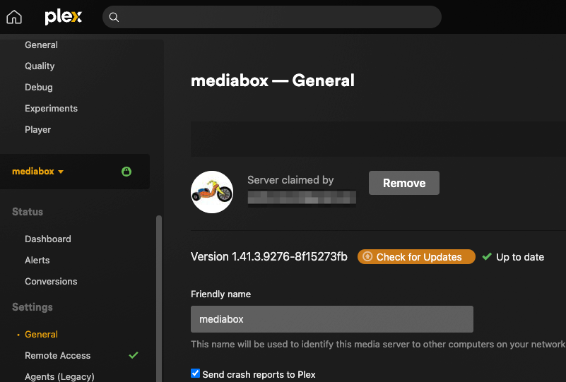

Have you not claimed your server?
I’ve claimed the server already, esp. considering that option doesn’t show up for me.
So you see your account signed in on the General Settings page?
