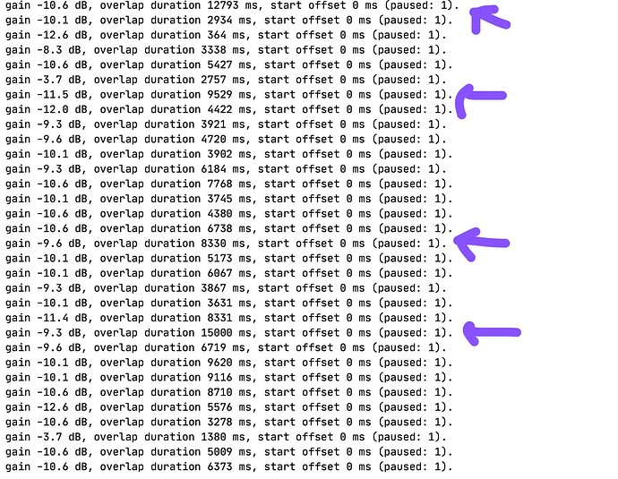

So if I look a your logs, I see Sweet Fades doing some overlapping.
Some of those overlaps are in the 5-15 second range.
Is this possibly what you’re noticing?
Thank you for the help. I turned off Sweet Fades and have not had the problem since. I am shocked that in the four years I have been using Plex and Plexamp, this has been my only bug. Keep up the great work.
