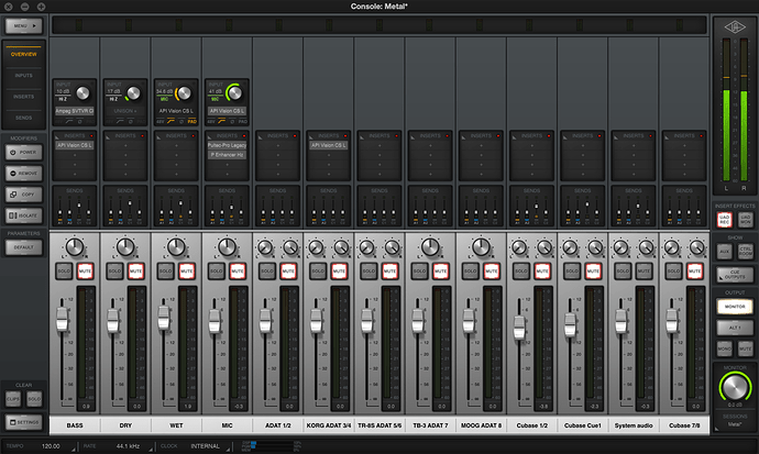

I use Universal Audio audio interface and their Console software, where there are Virtual routing (input & output).

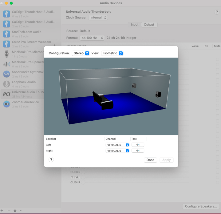

Plexamp bypass my setting and the sound is going straight through the audio inteface monitor / main output, instead of being routed on my Virtual channel 5 and 6 (named System audio in the UAD screenshot below).

I need on investigate more, the signal path is:
Plexamp => Sonaworks reference 4 => UAD
With system audio of the MacOS setup for virtual channels.
