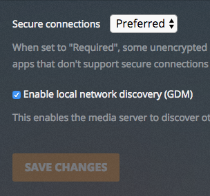

I’ve checked my server settings for the “secure connections” network settings on the Plex server, and I have them set to preferred and local network discovery turned on:
Ports are open on my router at home, so I’m assuming this has to do with the security settings at my job that I won’t be able to get them to fix. I wonder why it will work fine in Google Chrome, for example, but not Plexamp. That leads me to believe that maybe there is something that can be done about Plexamp? I would love to use use this app all the time!
