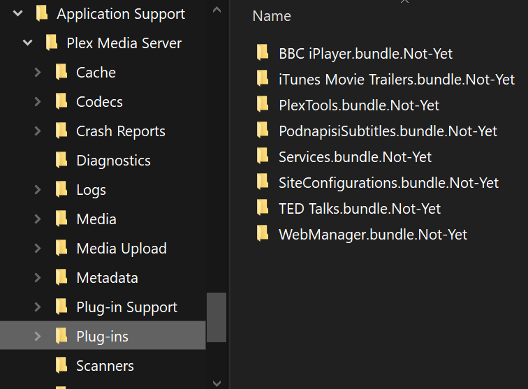

Secondary thought:
Until we diagnose what is looking like a startup failure,
would you rename your plug-ins from .bundle to .bundle.Not-Yet ?
This will stop them from being included with PMS starting
Thanks Chuck.
I did what you asked (I hope):
I cleared the logs out again and restarted; it lasted 18 minutes this time.
