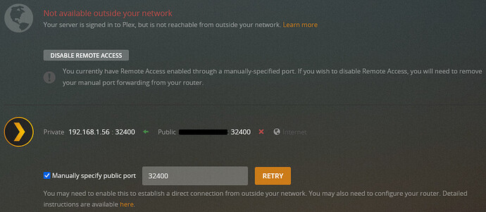

I am having the same issue but the recommendation above did no resolve my issue. I show successful remote access for a few seconds then it returns not available.

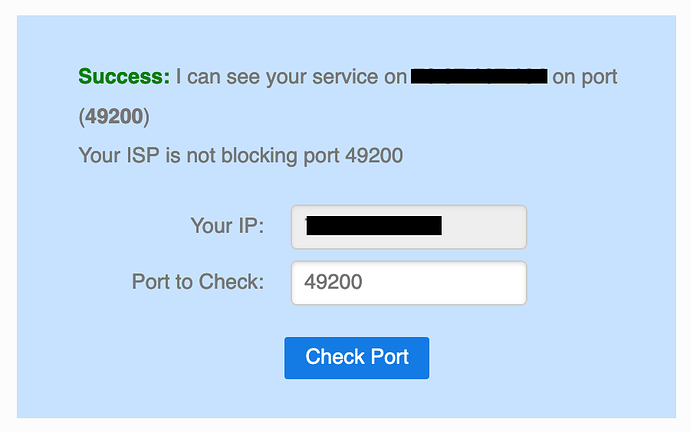

basic rules for remote access troubleshooting:
  1. can you confirm you actually established a manual port forward on your router using the same public port specified in Plex?
  2. can you access your router’s public IP address and the defined public port from outside your home network (e.g. using a service like canyouseeme.org)?
    • if this is working, the issue is likely between your router and the Plex Media Server (including both end points)
    • if it’s not working, the issue is likely between your ISP and/including your router

I think I am able to connect from outside my network ok:
My issue started after updating from DSM 6 to 7. Before DSM 7 I was able to connect remotely fine without a port forwarding rule on my router prior.
I also have UPnP off on my router before the issue started and still today.

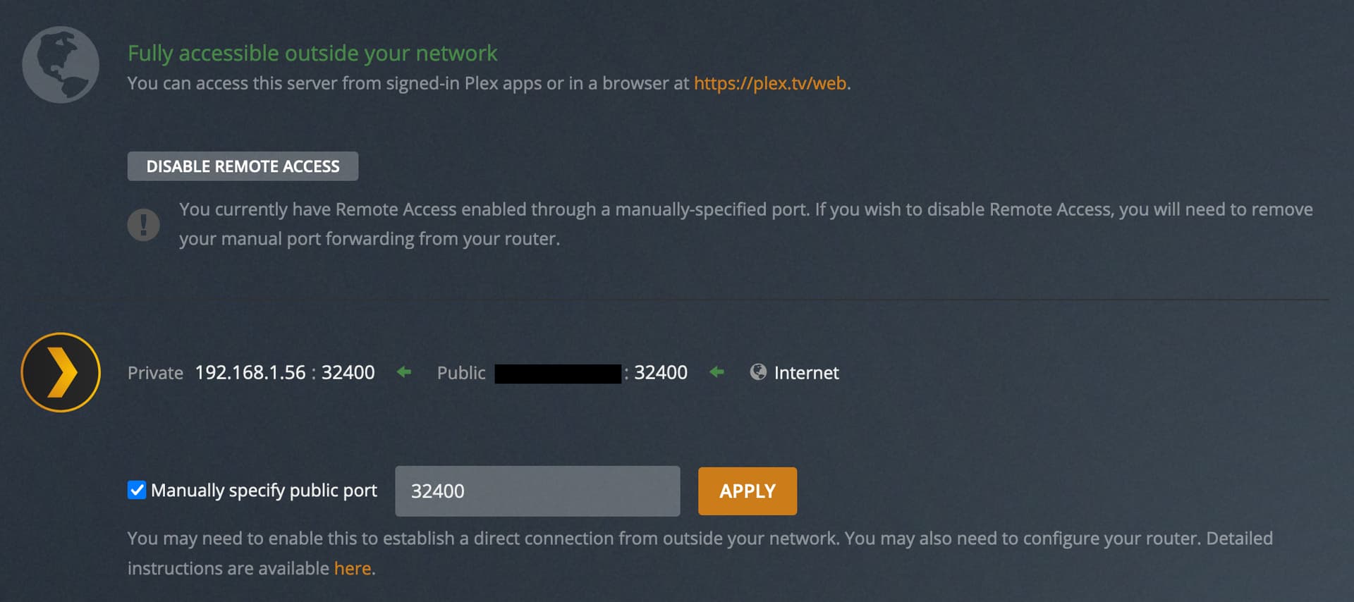

I unchecked ‘Manually specify public port’ again and Plex set both the public and private port to 32400. I seem to now have remote access.
That is with the port forwarding rule below.
Any possible issue with this setup?

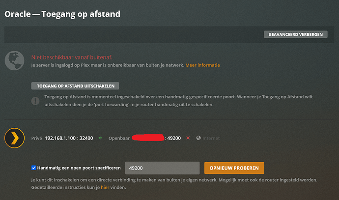

Well… you’ll need one of those to get it to work (UPnP vs. manual port forwarding). You might want to verify those ports though: according to your screenshots you’re telling Plex to go via port 32400 while you were checking the accessibility for an entirely different port.
