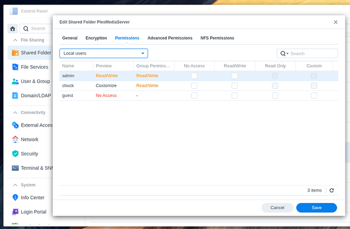

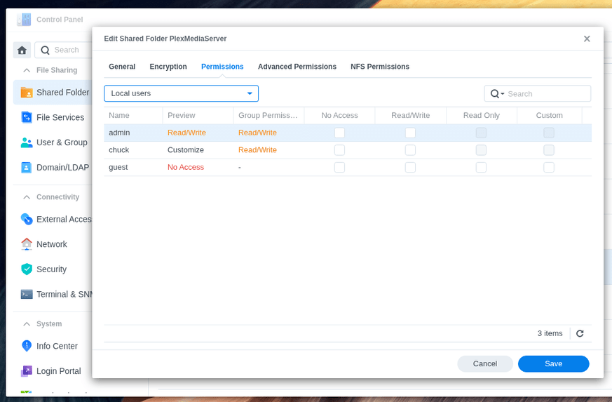

In DSM 7,
The PlexMediaServer shared folder must be RW for System Internal User PlexMediaServer.
The biggest changes in DSM 7 :
  1. Local user Plex → System Internal User (service) PlexMediaServer
  2. Shared folder Plex → Shared folder PlexMediaServer
  3. DSM (installer) scripting with full privileges → NO privileges to fix anything.
Please confirm your permissions are set as follows.
and (similar)

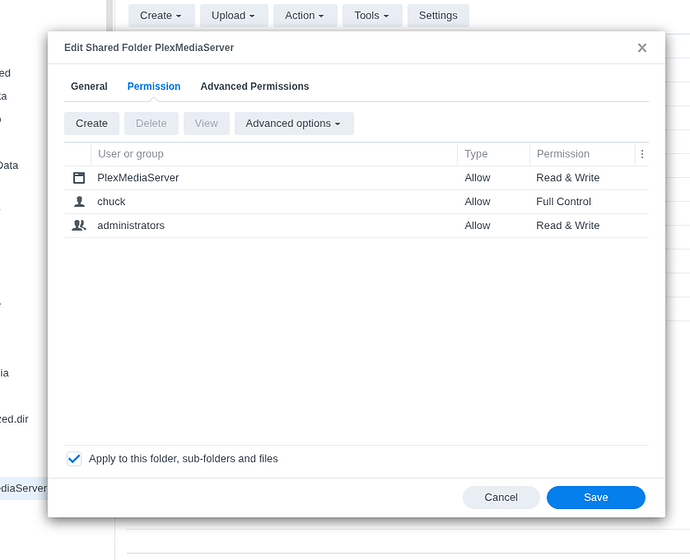

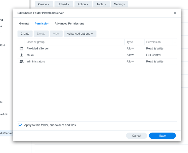

Using FileStation, apply permissions to all files (These are the ACLs DSM uses)
– your usernames instead of mine but same idea
Ensure Apply to this folder, subfolders and files is checked.
@ChuckPa Thanks again for your help. Things seem to be working OK now. I tried restarting my NAS and Plex eventually auto started. It just seemed to take longer than usual.
