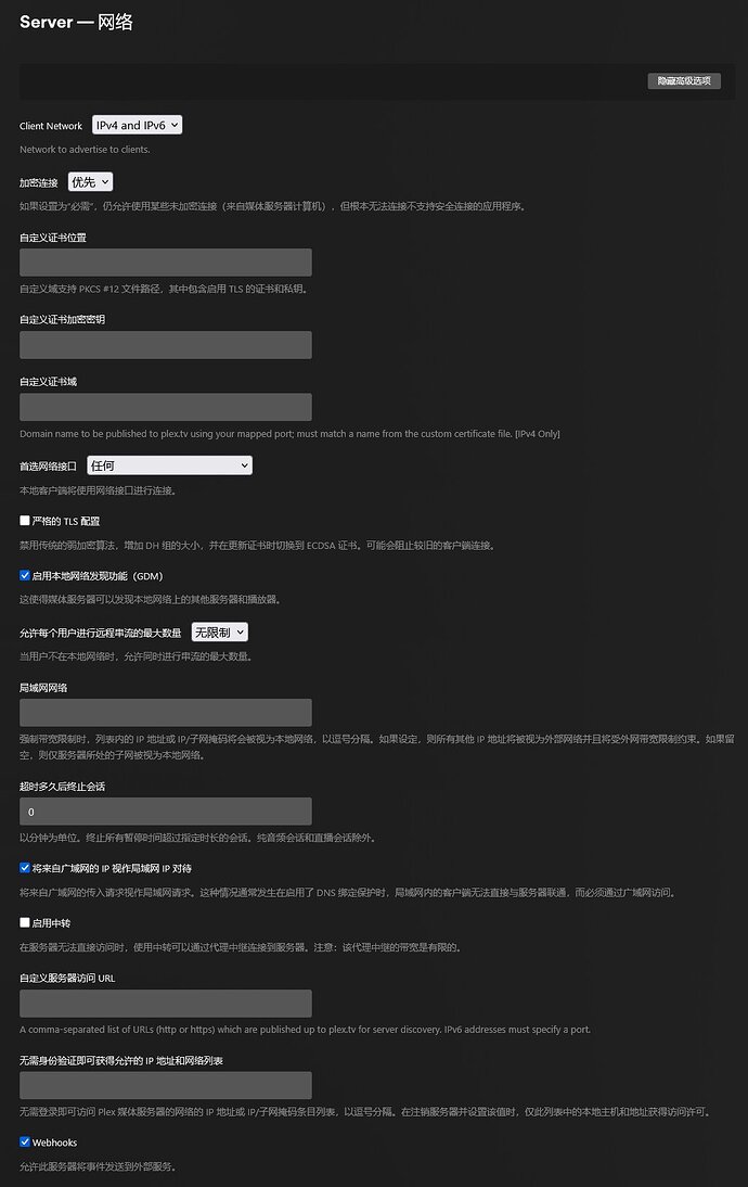

I believe the new version of Plex (iOS app) has issues with IPv6 network connectivity, as my iOS device cannot connect to my home network, which is a pure public IPv6 environment. The server running on my Synology NAS shows no response in the control panel. This is most likely a bug.After all, Plexamp has previously had IPv6 connectivity issues.
it’s my network shotcut.

Quite a few posts indicate that the New Experience iOS client doesn’t currently support IPv6, here’s the first three that pop-up in a search:
https://forums.plex.tv/t/remote-access-over-ipv6-on-new-plex-ui
https://forums.plex.tv/t/lack-of-support-for-ipv6-servers
https://forums.plex.tv/t/ipv6-support-gone
We don’t know for sure, because I don’t believe any formal responses have been posted by the Plex team, not confirming that IPv6 has been removed either temporality or permanently or confirming if this is a bug and if/when it might be fixed. Unless I’ve missed a post?
