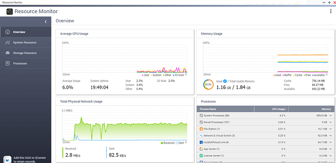

What’s making this more complex is how slowly the movie copies are going – generally 3+ hours for a ~30GB movie. I’m only getting about 3MB/s of transfer speed. I have the QNAP and the source (Unraid on a PC) both plugged into a Cisco switch, which is connected at 1000 Mbps.
Here’s a shot of the QNAP resource page:
Any ideas as to why this is so slow?

Regarding speed, then it can be lots of things, like half-duplex on one of the boxes, or AntiVira scanning etc
Thank you, Dane! I’ll definitely check out filebot. Could make life a lot easier.
And I solved the file copy speed issue. By mounting both NAS boxes from my main server (which is also directly on the Cisco switch), I’m now copying 30GB movies over in about 13 minutes at just over 400 Mbps, a 15X+ improvement! : )

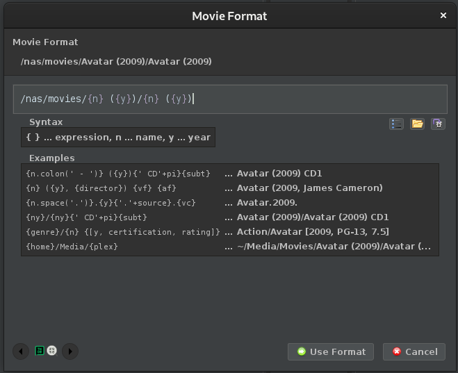

I’m looking at filebot and it looks like it could help with renaming files, which, for me, are currently some meaningless name (e.g. “01253.m2ts”).
However, filebot doesn’t seem to be able to do the folder restructuring, unless I’m missing something.

With several hundred movies to deal with, is there anything that could deal with the folder restructuring task?

FileBot knows the difference between renaming (moving) on the same volume and copying (to a new location).
It will clean up itself.
Consider the following example:
  1. Upper and partially covered window = Where files are.
  2. Select those to be processed (blue highlight)
  3. Drag & Drop into the left pane in FileBot
  4. Notice FileBot shows the file names. It also knows the folder name and will use that info – see next step
  5. “Match” starts the process o(you can do hundreds at a time once you are comfortable.. FileBot does prompt you to confirm any which are ambiguous)
  6. When matching is complete, proposed new names (with structure/location) in the right pane.
  7. Clicking “Rename” begins the Copy-Move & Rename process.
  8. If FileBot can completely empty the folder, it will remove the empty folder (cleaning up after itself)
