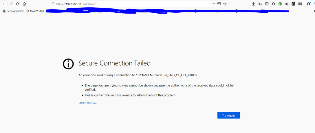

Installing PMS from QNAP Store, I launch it and get:
Secure Connection Failed
An error occurred during a connection to 192.168.1.###:32400. PR_END_OF_FILE_ERROR
The page you are trying to view cannot be shown because the authenticity of the received data could not be verified.
Please contact the website owners to inform them of this problem.
Are you connecting this IP via https or http?
When I hit launch, the browser opens with a URL that uses https: https://192.168.1xxx:32400/web
If I take out the “s” it just throws a 404 error.

I have 1.19.5 installed on my qnap but I can’t get in to it. This is the screen that I get in firefox and a similar one in chrome.

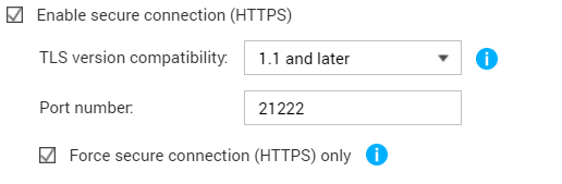

Secure connection issues:
  1. Are you using your own certificate ?
  2. Are you forcing HTTPS on the QNAP?
FYI: RFC-1918 addresses (192.168.x.x, 10.x.x.x, and 172.16.x.x - 172.31.x.x) are not publicly routable. They only exist inside our LAN. Nobody can get to them.
Yes to both. Certificate (obtained through qnap) is valid until next year and I have the box checked for forcing HTTPS.
Additionally, I have two port forwards setup one for the nas and one for PMS which is on the nas.
Everything has been working fine until yesterday. I updated the nas to 4.3.3.1354 but the release notes show nothing to do with plex other than the removed support for plex home theater (predecessor to PMS, correct?) from hybrid desk station which I don’t use.
I’ve read some of the advice you have given to others and I have deleted all authorized devices and tried opening in an ingognito window and I get the same error.
Fixed it,I think. I opened up another app which shows the nas ip and a port number on the tail end but it didn’t have https in the beginning of the address so I deleted it in the plex address and it opened and found the server and added the libraries. They are now rebuilding so I should be good to go.
