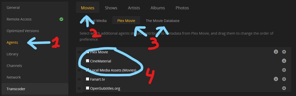

Thank you for the above information. I was able to solve the issue by changing the Movie agents. I’m unsure how my top movie agent became “Local Media Assets” but that was the issue.
In more detail, i was able to solve the issue by doing the following:
  1. I went to Settings > Server > Agents > Movies > Plex Movies & The Movie Database
  2. Under the 'Plex Movie' tab -- I dragged Plex Movie to the top position, CineMaterial to the second position and Local Media Assets to the third. (image below)
  3. Under 'The Movie Database' tab -- I moved The Movie Database to the top and Local Media Assets to the second slot. (image below)
  4. Ran 'Update Libraries'
That fixed it. Thankfully I did not have to do the Plex dance of moving my date around.
