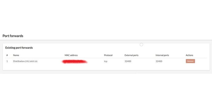

  • I have made a port forward in the router for port 32400 as you can see in the screenshot.

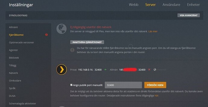

My problem is that Plex says Remote Access is denied as shown in the screenshot.

The indicator in the Plex settings can be a little behind.
If you can connect from the Plex Client on your mobile to the Plex server while you’re outside your home network (e.g. not connected to your WIFI), that basically means it’s working.
If it doesn’t, please check out if your router is actually accessible (e.g. using a service such as canyouseeme.org, using your public IP address and the public port used in the port forward).

I just realised something that i also forgot to mention earlier, the router i use is a special type of VPN router whose main purpose is to encrypt all traffic with OpenVPN. So this means that all of my devices connected to the router share the same public ip number and i assume i also share this ip number with other people also connected to the specific VPN server used at the moment.
Could this be the reason why Plex says Remote Access is denied?
Ok, so i just switched VPN server to a static IPv4 address and now Plex shows Remote Access as accessible. So i guess this static address has all ports open and that explains why it was denied earlier when i used a shared VPN server ip number.
Problem solved.
