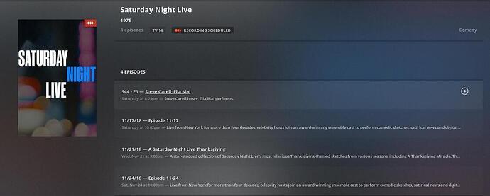

Here is what happens on my system when I do a search on SNL. As you can see, only the old shows are shown. The one that is actually NEW doesn’t show up because the EPG is reporting it as OLD.

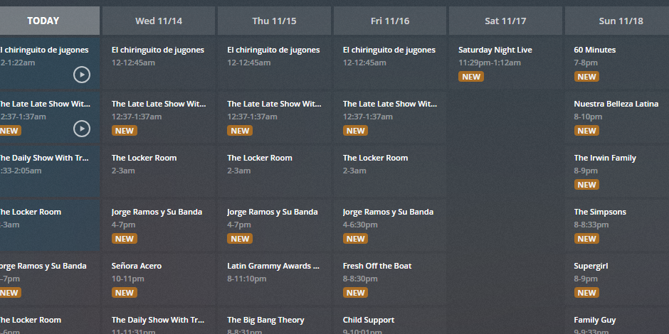

I think the issue is coming from the EPG provider and which cable provider or OTA … I have verizon fios and the guide seems correct … SNL will record at the correct time
Thanks @plexuser1427! It’s super terrific to see someone has a correct listing. But for those of us with at least 3 bugs preventing us from recording the show, your screen shots don’t make our problems go away.

That doesn’t appear to be the “Guide”, but rather your recording schedule. There are multiple issues going on here I believe… one is the EPG and what it is reporting to Plex… the second is what Plex is doing with the information. The cable provider or OTA is only significant in how Gracenote is storing information for that particular provider.

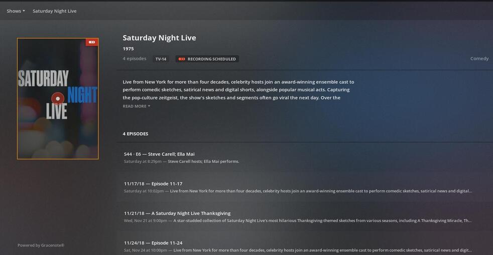

Please enter “Saturday Night Live” in your search bar as follows and post a screenshot…
Then select under Guide Shows “Saturday Night Live”… this is what it returned for me:

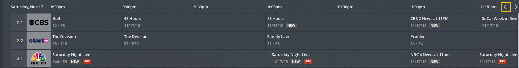

Then take an actual screenshot of your guide for Saturday Nov 17th, primetime as shown:
As you can see from the guide view it shows all three episodes are recording - however due to the override I did in the advanced settings, only the 23:30 showing is actually scheduled to record. What actually happens when the time comes is questionable.

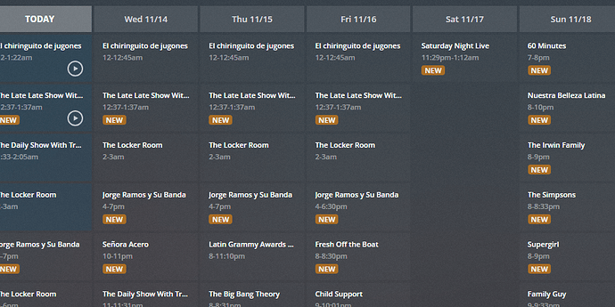

Also here is a screenshot from my Verizon Fios app with Verizon TV guide and it looks like Verizon is showing re-runs as new as well. So it might be a widespread issue with SNL …
