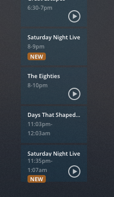

similar issue (screenshot from last night’s recordings). I have SNL set to record only new expisodes in the series. The one recorded at 8pm is def not new (maybe the EPG data is wrong here). This has been going like that the whole season.

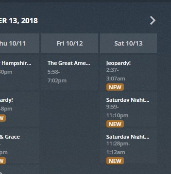

I am braced for impact. Here, we can see that Plex DVR is ready and planning to record BOTH SNL episodes this Saturday, 10/13. I look forward to watching them. What could go wrong?

Hmm, somebody somewhere changed something. It is afternoon on 10/13 and the first SNL is no longer marked as “new” which is good. I’m going to change my SNL recording preference to “New Airings Only” in hopes of getting a single SNL recording of the 11:30 Eastern time show this week. Fingers crossed…
I can report success this week. I was able to record the entire new show from 11:30 to 1:00AM on 10/13 by selecting “New Airings Only”. I’m guessing this was a result of corrections to the EPG since I have not updated my version of PMS since the recording failure on 10/6.

And now failing again on November 3. Please, please Plex stop this madness! It’s 11:20 PM eastern. I can see that Plex has already incorrectly recorded SNL at 10:00PM and decided not to record the NEW show at 11:30. But right up until 10:15 PM tonight Plex claimed it would record the 11:30 show. WHAT’s GOING ON???
fail_1 fail_2
