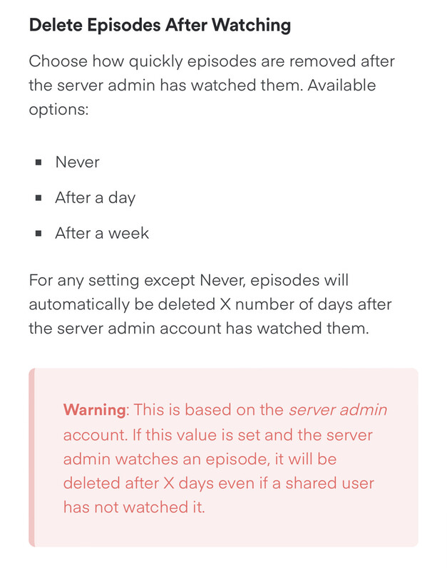

I am following this up - at the moment I think only deletion policy of never for watched would help
I am the server admin, and these shows are being deleted before I watch them. The tag in the logs says I watched them back in February so plex is deleting them as soon as they are processed.

I would have thought the logic of having the Recording settings of settings of “Airings” -“New and Repeat Airings” and then under advanced I have “Keep”- “All Episodes” then under “Delete Episodes After Playing”- “After a Day” would mean the new recording would be kept for one day after that date time recording instance. I realize I had watched it in Feb, but I like to have a selection of episodes to watch and they change. Just because I had seen it in the past doesn’t mean I don’t like to have it for background noise.
I realize this would be a nice feature for plex to have such a long memory for others who remember what they had watched, but for me I don’t mind I had seen it in the past. I wouldn’t have selected “New and Repeat Airings” for recordings If I didn’t want episodes I had seen in the past. I guess that was what confused me.
I liked the auto delete feature, but if that’s what triggering the immediate deletion as soon as the recording is finished I will have to manually delete the episodes I guess.
This is fine, I was just at a loss because the logic seems weird in my head and not only to me.

So, with the “Advanced” Feature of “Delete Episodes After Playing” set to “After a day” if I record an episode that I have watched even a few months ago, Once it is finished recording and processing it will delete the show’s file right away. Seems the “Fix” for this is to not use the “Delete Episodes After Playing” and set it to default of “Never” and then manually delete each show as needed to clear up space on the DVR drive.
