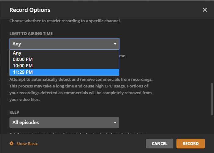

I am having an issue with the DVR selecting and recording the wrong SNL. I am in the central timezone, so the new correct SNL is on at 10:30pm. The PMS DVR reads a repeat airing at 9:00pm as the new SNL and records it. It then doesn’t record the 10:30pm airing at all. In advanced settings, it only shows as a 9:30pm airing only option. Any way to fix this?
Have you tried using the Limit to Airing Time option. Note this currently only works if you have the Minutes Before Start set to 0, any other setting will cause Plex to not see the episode.

I have, but the only time available to choose is 9:30pm. The correct airing is at 10:30
I had to delete recording, set new recording with no start before time, then select time limit. Just setting the before time to 0 wouldn’t pull up the correct time.
