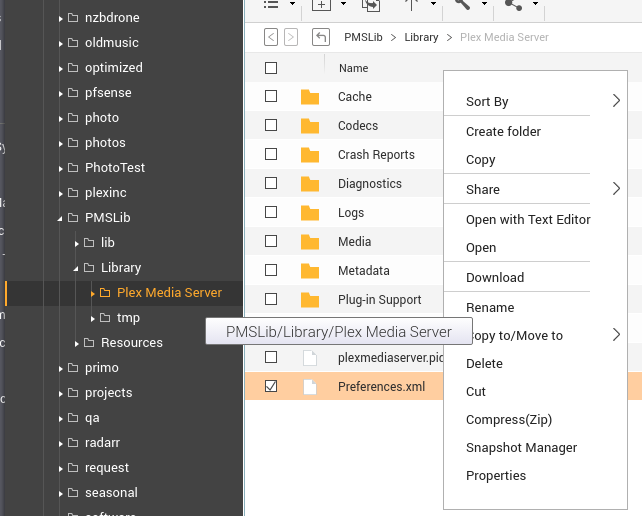

This can be done on QNAP without SSH.
It requires two packages be installed.
  1. QNAP “Text Editor” (from the QNAP store)
  2. PMSLibShare https://github.com/ukdtom/PMSLibShare/releases
IMPORTANT: This is a forced “Reclaim” of the server.
Following my Synology procedure, but adapting for the different directory structure (QNAP doesn’t have an “Application Support” directory),
  1. Stop Plex
  2. Perform the app.plex.tv -> Authorized Devices -> Servers preliminary step
  3. File Station
  4. Navigate PMSLib -> Library -> Plex Media Server
  5. Right-Click Prefernces.xml Open with Text Editor
  6. Make the same edits
  7. Save
  8. Make certain to be signed out of Plex/web (app.plex.tv)
  9. Follow the rest of the Synology procedure.
Screenshot from 2020-04-01 02-19-44

Do it from within the QNAP itself.
  1. Open App Center
  2. Click the magnifier (Search)
  3. Type “Text Editor”
  4. Enter
EDIT: Updated image to show how to search for Text Editor.
