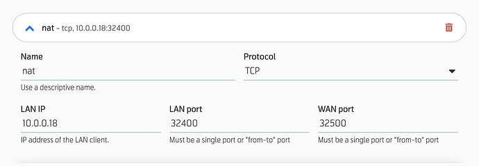

Here are my open port settings on the router:

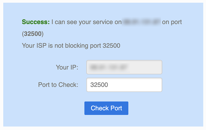

My access port check on canyouseeme.org:

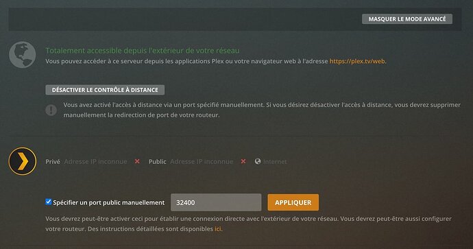

i have exactly the same error, everything is working well in local, but when I try to use remote access, is not working anymore:
And my remote access are not working, even is it’s green:
You don’t seem to have private or public IP’s showing in your PMS screenshot?
Is this with PMS 1.29.2 or PMS 1.30.0 ?
It’s an older version: 1.18.5.2309-f5213a238 the default one on Synology, yesterday I tried to update it to : 1.30.0.6359-1185e28d9
But nothing was working on the Synology, I was stuck on the screen please install a plex media server, even if this version was correctly installed in the synology, so I revert back to the default version.
Yes; i don’t know why, the IP adresse are not there, but the connection is green, also the port forwarding is there working also.

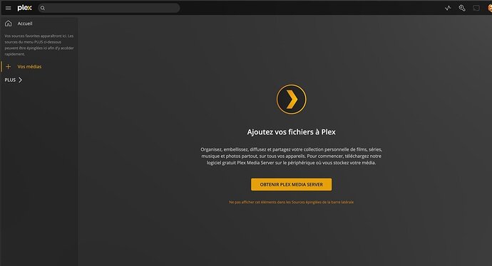

Ok, i just tried to install 1.29 and same error as 1.30, he couldn’t find the server:
