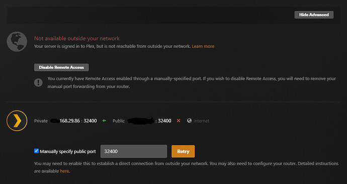

I have been having trouble setting up remote access for my PMS hosted on my windows PC.
I have enabled port forwarding, setup static IP, allowed Plex on windows Firewall. I am not sure what else is missing from the settings. Would be grateful if someone could help me out with this!
I‘m a bit confused with regards to your port forward configuration … most routers require you to specify the external/public port (range) that’s supposed to be forwarded (and usually you don’t need 3 rules).
You can find some general pointers on how to further troubleshoot and pin down what’s causing this issue for you in this guide…

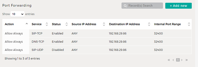

What is the make/model of your router?
It looks like you are forwarding the wrong ports.
SIP is port 5060 and DNS is port 53.
This is a guess, but you probably need to delete those three rules, then create a custom service/rule that forwards external port 32400.

The router i’m using is a Jio Fiber(India) provided device. In the port forwarding settings of the router, it does not list only TCP protocol. And trying different things I’ve added all the listed TCP rules just to see if it may work.

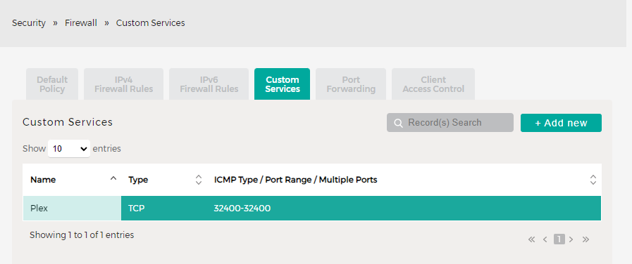

So, I’ve added a custom rule (Plex) in the firewall rules configuration which basically allows TCP connections destined to my private IP.
Thanks for the screenshots.
Defining a custom service for Plex is the correct process.
Delete the other three rules. They are not needed and, if enabled, may conflict with Plex remote access (you still have the DNS rule enabled).
After deleting the other rules, reboot or power cycle the router.
After the router is completely back online, reboot the Plex Server.
Then try to enable Plex remote access.
If it does not work, run through the troubleshooting document @tom80H linked above.

I have created a custom rule in the firewall settings and assigned it in the port forwarding rules:
I have created inbound rules in the windows firewall settings for port 32400.
