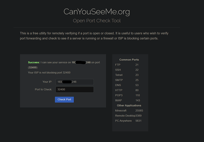

For some reasons my PMS running on a ubuntu server showing the wrong public IP at the remote access section and failed to connect. I have double checked the port forwarding and it’s working fine.

Like you, a port check shows the port for Plex is open and Plex can be accessed via its external IP. I think for me at least it’s a DNS issue with Plex domains or it not correctly updating on their side.
