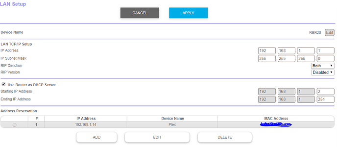

I attached the screen grabs of my settings, but I must admit I’m not really good with networking. If anybody knows what could be causing this, I’d really appreciate your help.

Capture4
Your setup looks ok. If you cannot access the router from the outside (e.g. using canyouseeme.org with your public IP address and the port you have forwarded) you might check a different port first (in case your isp is blocking this port in particular.
If this still doesn’t work you should contact your ISP if the block certain Ports and could unblock this for you (some ISPs do that for security reasons… sometimes those are reasonable, sometimes they’re not).
If your ISP is basically handling his network as his own „home network“ instead of actually assigning you a public IP address (e.g. 10.x.x.x or 192.x.x.x bands) you could ask them to provide you with a public IP address (not necessarily a dedicated one… however the ISP might try to charge you with some extra cost.
