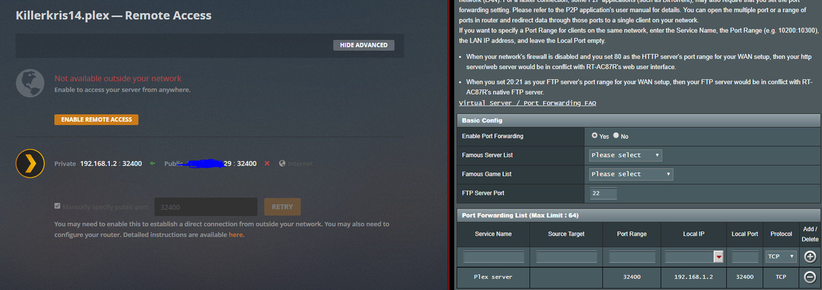

Im having an issue getting the plex server avalible over the internet.
I have forwarded the 32400 port
I have ensured the manual port is set in the Remote access page of the server
Since those settings have been saved, both that router and the server machine have been restarted.
yet there is still not connection from outside my home :
can any one help me get this worked out?
honestly im very tech savvy, yet not very good when it comes to advanced networking IE: port forwarding and the like.
thank you in advance

2 questions:
  1. what happens when you click Enable Remote Access? Sometimes remote devices can connect despite the settings telling you otherwise…
  2. can you access the port from the outside? – you can e.g. test this using an online service such as canyouseeme.org or ping your public IP and that port from a remote computer

When I click enable remote access the page refreshes and it ends up the same as the image above.
For a split second it all turns green. saying its connected, but it refreshes again to disconnected state.

EDIT::: canyouseeme gave me a Success note, that my external IP with the port 32400 is open, yet i cant connect to it externally
