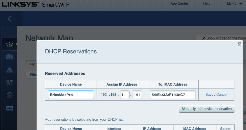

-Created a DHCP reservation for my Mac Pro IP in router settings for static IP

On WiFi make sure your IP on your PC on WiFi running Plex matches the port forwarding setup in your router and if you can post your port forwarding configuration you dont need to grey out your IP on there as that is your private IP and safe to post.

This is how they were setup. Have not made any changes yet. looks like they match.
That all looks right!
