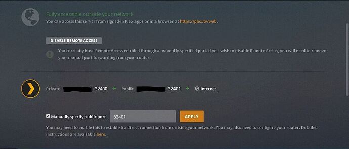

Remote access not working but shows fully accessbile
Server Version#:1.15.6.1079
So starting yesterday, my server is no longer accessible remote. Server under Remote Access says it is fully accessible. Already verified port forwarding is correct, disabled firewall briefly and still no access, MTU’s are correct, rebooted server, etc. Port is manually specified and not in conflict on the network.
Streaming on LAN still works fine, but no client at all can access remote. I was on an older version and update to see if that would resolve the issue and it did not.
Have you tried letting it automatically port forward for you? As in remove the tick from “manually specify public port” and let UPnP from your router handle it. (just remove the tick, disable/enable remote access and check if it works).
Another thing you can do, is goto Settings -> General, and then just “Sign out” of the server and Sign In/Claim the server again. All it does is re-fresh your token again, as it may have expired and possibly why its not connected remotely.
