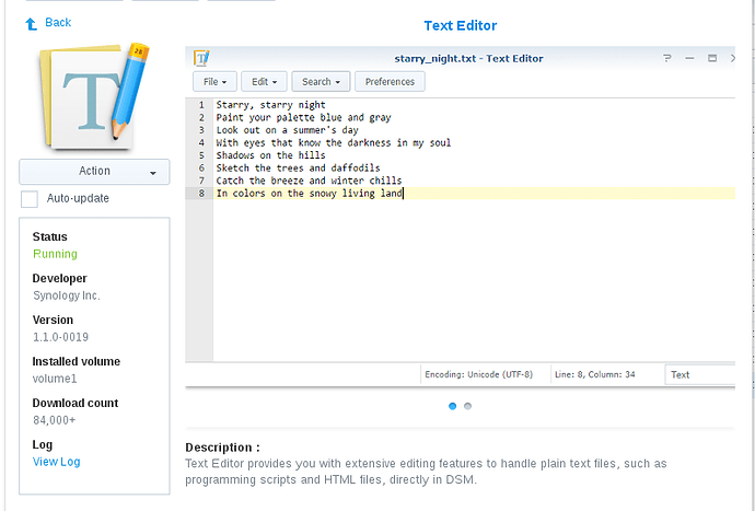

Now, right click on Preferences.xml and ‘Edit’ using the built-in text editor. If your machines does’t have that by default. It’s a tiny, 30 second install, from Synology. It’s great because it’s graphical and Linux formatted.
Please use their editor

Right click on the file from within File Station and ‘Open with Text Editor’ (this is the Synology text editor, previously bundled with DSM by default, now available as a package to install
I receive the same message about File Does Not Exist either by double clicking the file, right-clicking and selecting open with text editor, or opening text editor first and then browsing to the file. Seems to be a permissions issue.
I am able to copy the file, edit it elsewhere using the text editor, and then delete (or rename) the original and copy back.

  3. Without leaving the “Plex Media Server” directory and “Preferences.xml” highlighted, open With -> Text Editor to edit it.

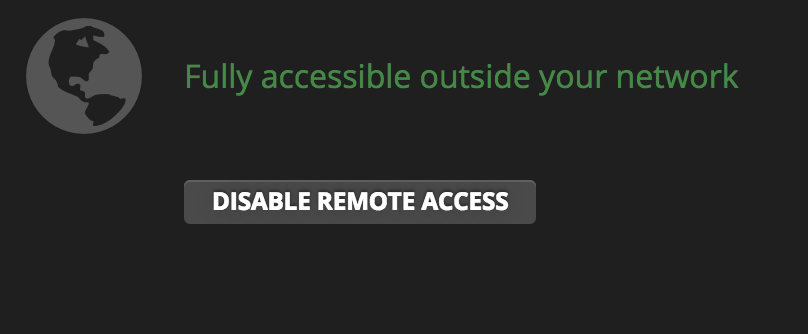

Well, oddly enough, I just refreshed the remote access page, without doing anything else, and now it appears to be fine:
So I guess this was probably the solution but it doesn’t necessarily return the right value when you do it. Have to refresh after trying to reconnect.
