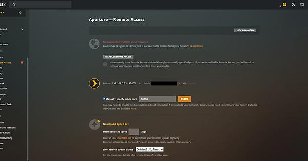

Next screenshot shows remote access, as it usually appears right now.
Imgur
If I click “retry” it will make a successful connection (https://imgur.com/FfrlA0N), however after a few seconds and refreshing the page, it goes back to the not working status again.

Your router has automatically, via UPnP, created a port forward for external port 50000 (TCP) to internal port 32400 (TCP):
This is likely interfering with your mostly correct, manual port forwarding configuration; I say “mostly correct” because your manual rule only needs to forward TCP, not both.
You could try disabling UPnP on your router and use only manual port forwarding; however, this could break other things on your network which rely upon UPnP.
You could also move Plex to a different external port.

Nevermind, that did not work after all… just gave me false positives for longer. I checked on my phone via 4g to confirm it wasn’t connecting.
However I followed your advice philipsw and disabled UPnP and that appears to be working better. Will post back again if I encounter further issues. :slight_smile:
