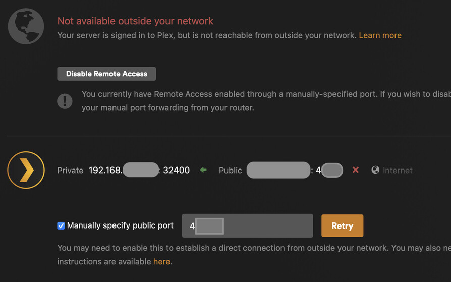

Remote Access / Port Forwarding works momentarily... then fails on my server!
Server Version#: 1.41.8.9834
Player Version#: 4.148.0
Title says it all.
I’ve looked and looked for hours trying to find an answer to this–something tells me it’s much simpler than I’m making it.
I built my own Unraid server (first time for me) and also upgraded my router to a Ubiquiti Dream Router 7 so I could have more fine tuned control over things exactly like port forwarding. I also set up a static IP for my Plex Server so that the IP address is always the same.
Whenever I try to manually port forward on my Plex server, I set up the port on my router, confirm it’s saved and loaded, and then enter the port into the settings in my Plex server.
It works! I can test it with my phone on mobile data and stream flawlessly.
But then.
Within either a few seconds or a few minutes…
It fails. Always. And I have no idea why.
Example screenshots are uploaded here:
Not sure where to go from here but if anyone can help me or point me in the right direction, I’d seriously appreciate it.
Thanks!
It works because of plex relay. Do you have a public IPv4?
Is it actually not working or just reporting as failed on that screen?
Mine flips to “not available” with red warning all the time but it’s actually working just fine, just the reporting\check seems to not be reporting correctly. If I hit “retry” on that screen it usually goes back to green for a bit but eventually goes back to having a warning. I’ve never had issues with remote streaming (me or a couple of friends\family).
It says that but it’s working just fine right now.
I dunno why mine regularly reports “not available” but I guess it’s probably related to my DNS filtering or security\adblock\routing\caching on my gateway interfering with whatever service Plex uses to see if it’s open.
You might try a port checker to verify if it’s actually getting blocked: https://portchecker.co (use your public IP or dynamic dns).
It might help to post your port forwarding rule just to be sure? I mean it’s pretty straight forward but still… :slight_smile:

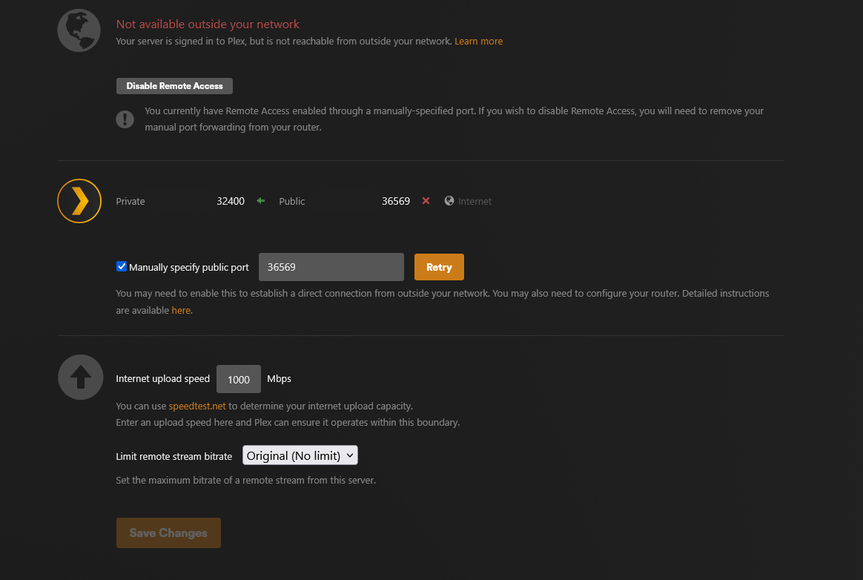

I am having a similar issue. Everything worked perfect up until three days ago, I could connect from any device on my local network and connect remotely no problem, successfully using port forwarding to reach my server. Zero changes I’m aware of since then, and suddenly this problem started happening.
Plex Server reports Remote Access is not working (“Not available outside your network”). When I click the Retry button next to the manually specified port (yes it’s the correct port I’m forwarding, yes the public IP is correct, yes the server IP is correct, yes port checker reports the port is open), it succeeds and stays that way momentarily. Moments later, it switches back to Red with the same “Not available” message. Super irritating.
Clients (Plex app on Shield TV, Android phone, app.plex.tv) report libraries are offline. Server reports everything is fine, except for the Remote Access issue. No firewall changes, everything looks correct, no network, server, or app changes. Server is claimed by the correct account. Tried basic troubleshooting (restarting server, logging out/in of server and apps, clearing app data), no dice.
Server is running on Windows 11 Pro, no server side VPN, etc. Again it has worked flawlessly for months/years up until today. Server version 1.41.8.9834.
What gives?

If there are folks with one type of issue vs another here, it’ll probably best if this topic sticks to whatever @KyleOfTheBeard is experiencing and start a new topic for the other one.
So Kyle - are you having problems actually accessing remotely or just with the remote access page reporting incorrectly?
Ooo… forgot about DSN Rebinding. I had to add a special command into Firewalla and whitelist on NextDNS\ControlD to help with Rebinding. More complex routers - like Unify and Firewalla - usually have rebinding controls to manage (particularly if using Unbound). Here’s Firewalla’s instructions for adding it:
For users who are using Plex, you can configure your box to allow plex.direct to be resolved to private IP addresses. For example, add the following to a file ~/.firewalla/config/unbound_local/plex.direct:
server: private-domain: "plex.direct"
I don’t know how it is now but Ubiquiti made it very difficult to disable or selectively filter dns-rebinding.
Hahah thanks for this! Had a busy day and didn’t get a chance to respond to any of the comments.
I believe I MIGHT have gotten it working? @ChristianKent’s suggestion to forward the 36569 port to 32400 seems to have been the solution to getting the Remote Access working consistently. The settings for Port Forwarding in Ubiquiti are a bit lacking in clarity, and I believe I was forwarding the ports in the reverse order they were meant to be.
Had a friend in a different country test it just now and he said it’s working flawlessly. So that’s cool.
As to some of the other points people have commented on:
  • UPnP was never turned on on my router
  • The remote access genuinely wasn’t working. I kept getting ‘Server Unavailable’ whenever I tried to test it on my end. So it definitely wasn’t just the Remote Access page being glitchy. As of right now, the Remote Access page is staying firmly in the green when I refresh it.
So to recap: this seems to have been due to Ubiquiti making their Port Forwarding a little confusing. But I got it in the end.
Thanks so much for all the help! You guys rule.
No, as I mentioned remote access is not working. I can login, but all Plex clients (mobile, Shield TV, app.plex.tv) report all libraries are offline. Local network and remote. This just started happening out of the blue. Worked fine Saturday, no changes, no longer working Tuesday. Again portchecker and canyouseeme report the port is open, which makes this all the more perplexing.
To ensure I have my port forwarding rules are set up correctly, I tested a different rule by closing the receiving app on the destination system first then checking portchecker and canyouseeme, both reported the port was closed, as expected. Reopened the receiving app and checked again, both reported the port was now open, as expected.
I started a separate thread, but interestingly, PlexAMP connects and can see my music library just fine (locally at least, remote still seems to not be working with PlexAMP either). Again, though, Plex clients for video show all my movie and TV libraries as offline.
No DNS filtering on the server or router. I’ll try a different port to see if that makes a difference. Will also review the logs for what was suggested, but I don’t have a fancy firewall or complex network configurations in my case, and am not using my own DNS, am not running in Docker, etc.
I see it - Local and remote access spontaneously stopped working
