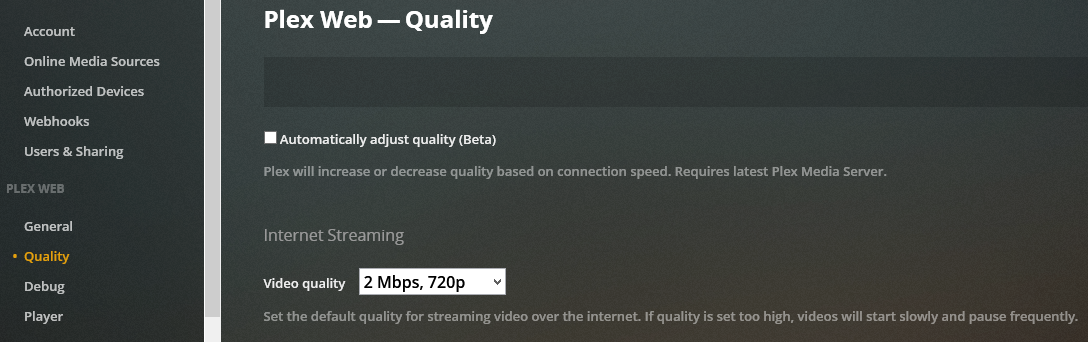

Did you check the remote quality settings on the computer you’re using to access the Plex server with remotely? The remote streaming quality setting on clients is set really low by default. Might just need to adjust that setting:
it is steup at most so i don’t think that’s it

Whatever, dude. If you changed your username your earlier posts would not show the old one. Also, your logs show two people interacting with the server – aymarguillambert@aol.fr and amb1099@protonmail.com. I was going to ask which one you were to make sure I was looking at the right playback logs, but at this point your should just be real and say “my remote user is having trouble”. :roll_eyes:
Speaking of those logs:

Sep 08, 2020 04:57:12.888 [0x80c346700] DEBUG - Streaming Resource: Reducing playback quality for 1904kbps stream bitrate: video resolution to 720x300, audio channels to 2, quality to 68
I’m not the biggest wizard at log reading, but this looks like exactly what I was talking about on my first reply here. Plex is seeing a limitation of 2 Mbps for the stream, it refactors the 10 Mbps video stream for transcoding, and then runs into the 7.1 channel audio, which it can’t play back in Chrome, and eventually you get 2 channel stereo downmix and 720x300 video.
So not sure if the user here really has not fixed his remote streaming quality settings, or if this is an issue with no direct remote access (I didn’t look too closely at the beginning logs where the server was booting up). If Remote Access is really failing out you need to get that fixed first, and I don’t know enough about your network setup to comment further. If you got your router from your ISP I’d be suspicious of it. I gotta go for now.

but the issue is similar with 2 users, if i connect me with my admin or other remote user on connexion public (WAN) my image quality is low in both cases (720p) but with any user on local conexion not problem , so the remote user is not problem for me, even if plex seeing a limitation (i have delete several time that’s has maybe delete preferences at same time) , my user admin has not a limitaion for the stream.
