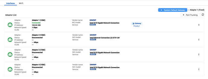

I found out what was happening on mine. I had system gateway set to default adapter 1 with adapter 2 set as fail over. i found the default gateway failed over to adapter 2. Once i switched it back to adapter 1 Plex is now able to get be accessed out side the network. I have not clue why as all ports have access to the internet. and it should should not matter.

btw do u have “Auto-select system default gatewaty” or the Select the system default gateway.
This is legitimately the first response I’ve seen that is different and actually makes sense. I’m going to try this out now and see.
Not sure who you are asking i want to think you are asking me so i will say,
i have the system default gateway set to select the system default gateway “not auto select” with fixed gateway adapter 1 as fixed and secondary fail over set to adapter 2
This is how I have it setup currently and it’s still not working.
I have tried EVERY combination ussing 1 and and 3 adapter
all 3 adapters , auto select , manual select.
What I don’t get is why sometimes under lets call it manual , some times 1 or 2 or 3 have the blue earth showing connected to the net. an hour later different ones ‘connected’

Ahhh i see you only have one port lit up i have all 4 of mine lit up. That defiantly does not make sense for your situation. if that is the case i would start to look at the router. What type of router you using? Are you using upnp, or port forward? 1 router or 2.
