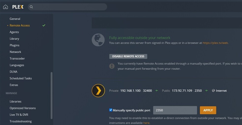

Now it says connected but it really isn’t connected. And then says not connected.
These are my settings. What am I doing wrong???
The port forward is configured correctly.
Try leaving the port at the default, 32400.
You can change it later. Also, low port numbers are more often in conflict with other services. It you want to change it, go higher.
hi, After many more hours I finally got it working. I think.
I found a free tool for port checking that is very reliable.
Port Forward Network Utilities
It said the TCP port was always closed. I was using 2350 external,
and took your advice and used higher.
But in addition to that , I had to get McAfee firewall port settings to open PLEX, TCP=port higher, and then the port checker finally said it was open. then I had to disable remote access
and then finally enable it with my specific port. Using higher was a good idea.
Thanks for you help.
