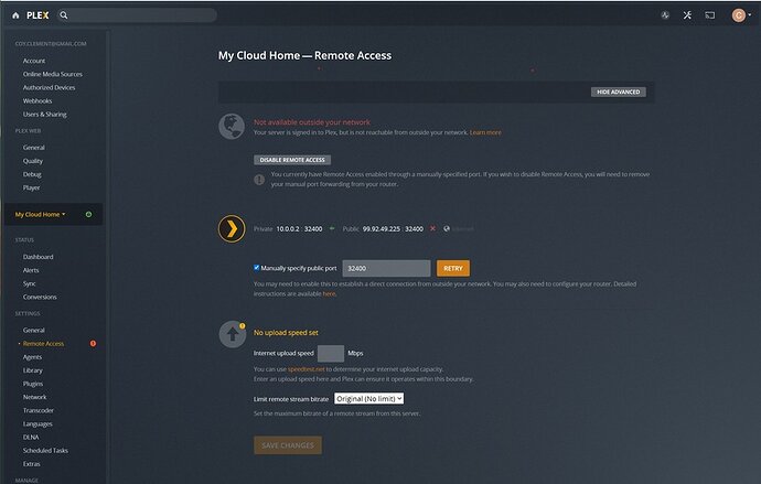

When I sign in to Plex through my web browser I see two servers (my laptop and the NAS Home Cloud server). The laptop server seems to be fully accessible outside my network, but I can’t get remote access set up for My Home Cloud), although I have opened the 32400 port.

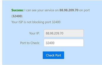

And I see the 3200 port opened ( Open Port Check Tool – Verify Port Forwarding on Your Router (canyouseeme.org))
And I can’t get remote access to work for My Home Cloud
But I do for my laptop server

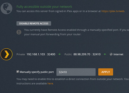

I have opened the 32420 WAN port
And also set it up on Plex
But it’s not working. I must be doing something wrong

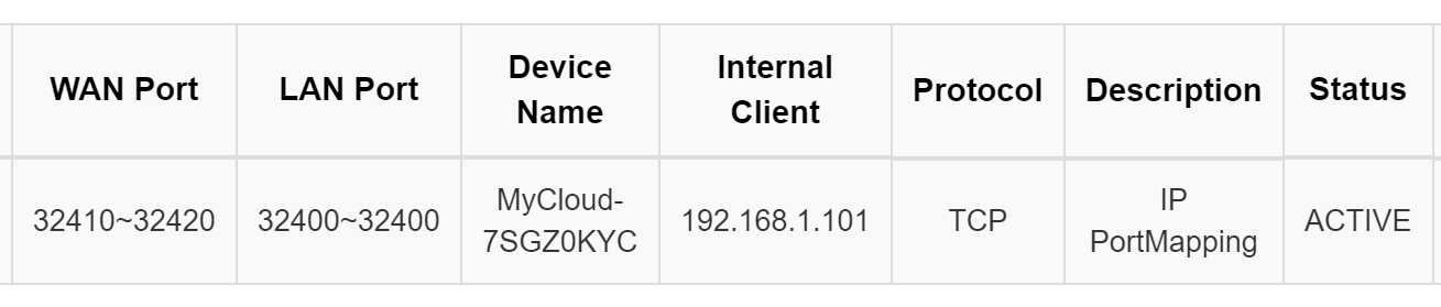

I opened a range 32410-32420
And set them manually on Plex, but doesn’t work for either of them
You got this mixed up.
You need to configure 2 separate port forward rules in your router:
  • one for the Plex Media Server running on your NAS
  • one for the Plex Media Server running on your laptop
Each of them needs its own dedicated WAN port (no ranges needed… just one port that’s different from that used for the other server) that’ll then be routed to the respective server (LAN port = 32400).

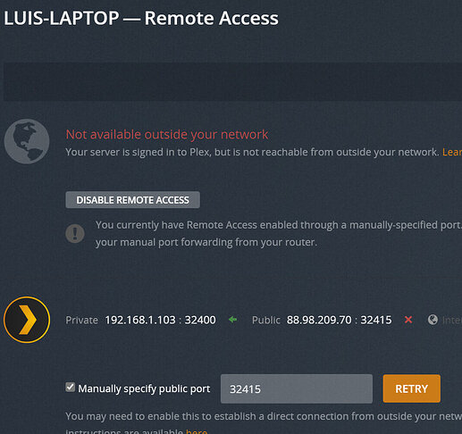

In your example, the router configuration should be like this:
  • Server 1
    • WAN port: 32415
    • LAN port: 32400
    • Client IP: 192.168.1.103
  • Server 2
    • WAN port: 32416
    • LAN port: 32400
    • Client IP: 192.168.1.101

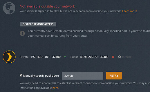

I absolutely can’t get Plex to work. I’ve check my router configuration, made sure it’s got IP passthrough (i.e. not Double NAT).
When I go into the web config I do “retry” and it remote access shows “accessible outside your network”, Then about 15 seconds later it shows “not available” - it just flashes and boom it’s not available.

  1. check if it’s actually not working or if this is some hiccup of the status indicator
  2. verify if you can access your router’s public IP address and the defined public port (you can test this using a service such as canyouseeme.org). If it’s not visible at all, there’s likely an issue between your ISP and (including) your router configuration; if it’s accessible but remote access is still not working, the issue is most likely between your router and PMS (including both endpoints).
  3. review the steps described in the remote access troubleshooting support article
PS: please mind the forum rules and don’t try to hijack other threads; if this issue persists we can move your post to create a new thread.

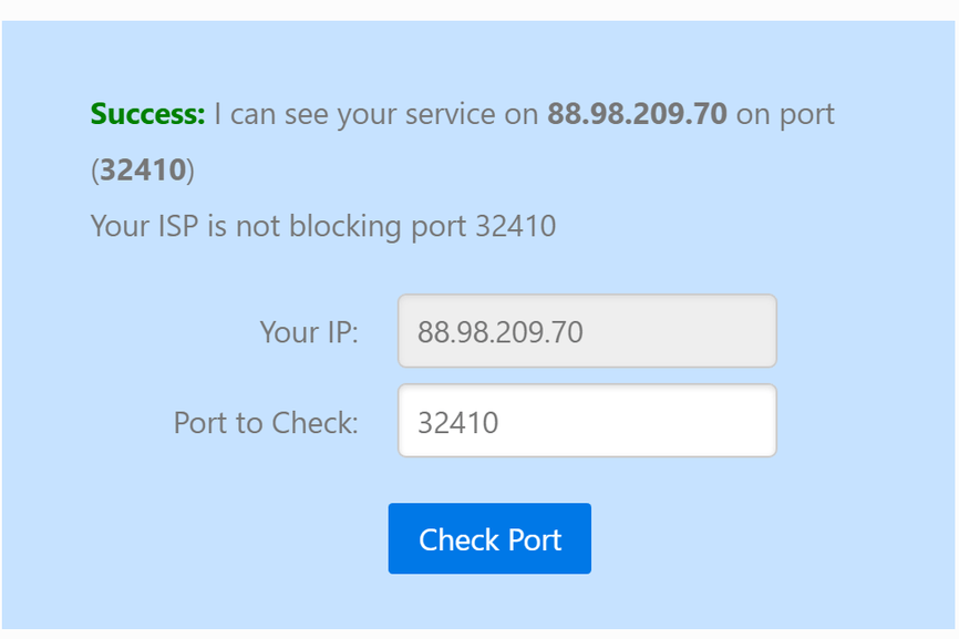

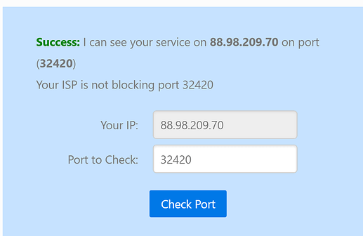

Test via canyouseeme.org works for both ports (32410, 32420)?
If so… does the issue persist if you (1) disable/enable remote access on the MyCloud PMS or (2) restart the NAS?
I will reboot the NAS as I can see both ports

This might be related to WD still only offering an ancient version of the Plex Media Server (v1.18.6 was released in early Feb 2020). If I remember correctly, there used to be an issue where the status indicator implied remote access was not working while apps could actually access that server just fine. Can you check if this could be such a case where the status indicator is simply off?!
Thank you so much
Does it mean that the issue is that WD hasn’t updated their Plex software in a while?
I have disconnected my mobile phone from the network and have tried to access via Plex mobile app a content on My Home Cloud server (using data), and it seems to be working. Is that a correct way to test remote access outside of my network
Thank you so much for your incredible help
Yes, if your mobile is off your WLAN and uses mobile data instead you’re outside your home network. Therefore if you actually can see and play your media from that server, your remote access is actually working (despite the remote access status indicator saying differently).
