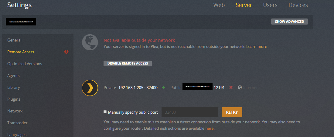

I have also, as per the images above, tried manually setting the ports to 32400 and port forwarding it.
Have enabled and disabled remote connectivity a lot over the past week.
If you look back to the images you will note that I have put two sets of images on the original post. one set that has no manual configuration of the port with an image showing the router automatically forwarding the public port of 12191 to 32400 and one set of images with manual port forwarding set on both plex and the router.
Automatic / UPNP setting on router…
Manual port forwarding…
