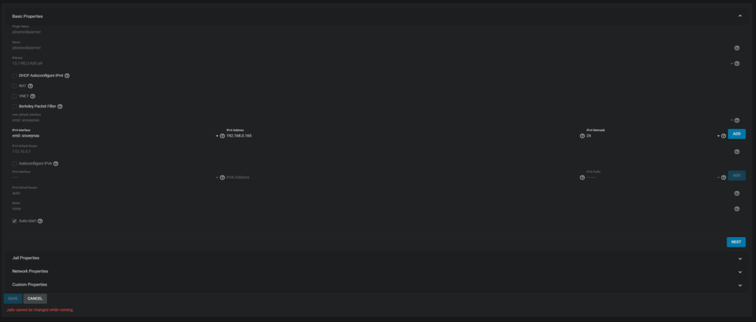

VNET is required to be on when running DHCP on TrueNAS Core so I’ll set a static IP instead to be able to try a “No VNET” route.
(scratches head) TrueNAS Core requires a static address for the primary interface, then can use DHCP for VNET interfaces? Interesting. I’d expect some MAC address work to be taking place there to allow DHCP bookkeeping to succeed.
Is your TrueNAS Core static address on the same IP network as your local clients? If it’s not, you need to list all of your local network in PMS Settings/Network/Local Networks. Be careful with that field, it’s very picky about exact syntax. You’ll also need an appropriate IP gate, probably in your network router. Based on your above ping testing from Win10, I’d suspect you’ve got networking in place.
TrueNAS Core doesn’t require a static address I just have one set to make accessing SMB (Windows Share from NAS) easier from my windows PC.
I believe my PMS is working properly and now is direct connecting to remote devices and still treats my local devices as local devices and doesn’t classify them “remote”.

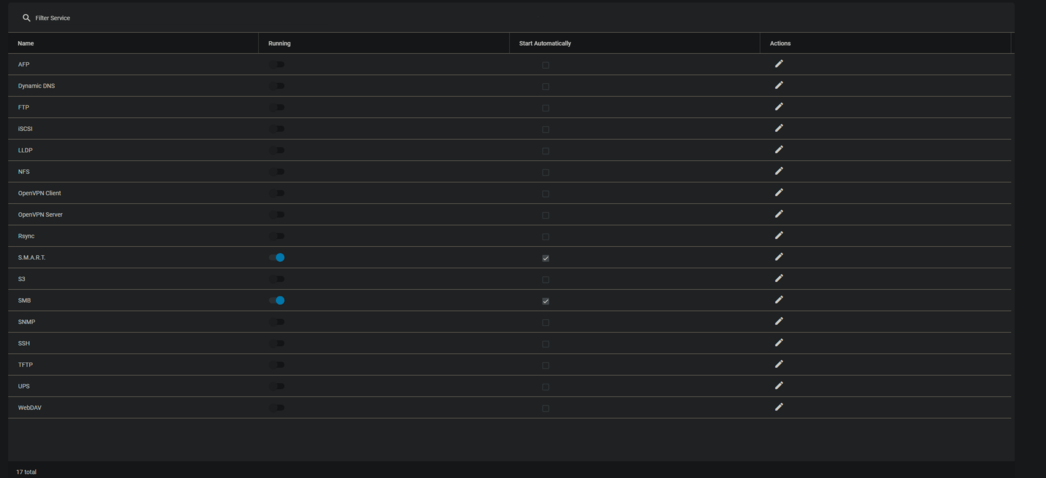

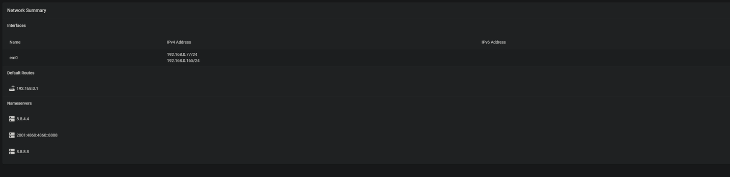

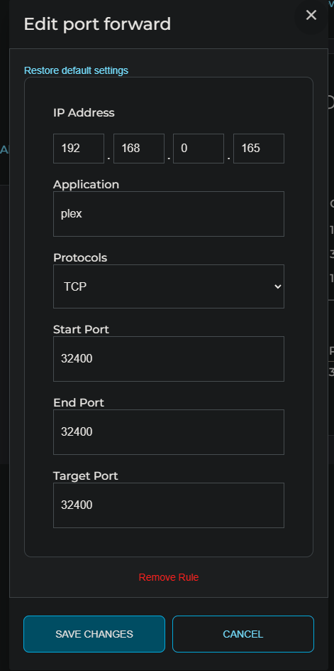

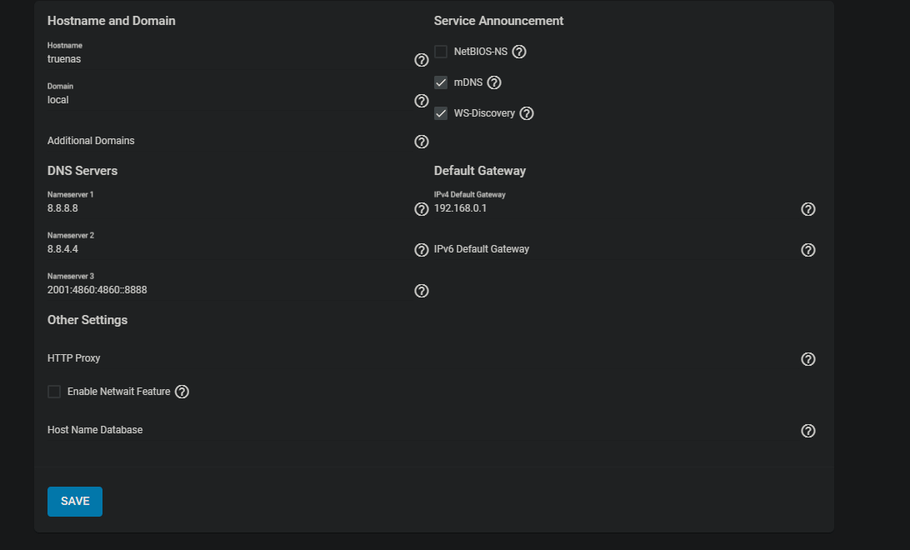

I think my problem was netmask settings but am unsure. I’ll post pics for others, hopefully it helps someone :slight_smile:
