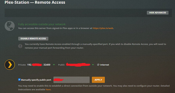

I needed some help with my Plex remote connection issues. I understand that there have been many discussions around this in the forum but none of the one I came across has a solution to this issue listed. most of the posts are trial which I tried and have failed in succeeding. I am hoping that I can get some assistance from anyone who has been on the same boat/or knows the solution to this painful yet frustrating issue :frowning:
Below is the Pic that would show that I have access remotely yet I cant access my library outside my local network such as on phone,tablet etc.

I do have a manual port forwarding set up with TCP/UDP allowed and can confirm that it is working as I checked on the site https://canyouseeme.org/ and on Open Port Check Tool - Test Port Forwarding on Your Router
both locations show that the port is open and is working.

Had a chance to go through the logs. I also created a rule to monitor when everytime a connection is made on my port. Could clearly see that the connection is passed and allowed so 100% sure it’s not my firewall. However, it could perhaps be as @Brad_S mentioned that the UPnP is flaky at times. I didn’t know about it, I was pretty much following what the document stated. so thank you @Brad_S.
Surprisingly today my Plex has started working as normal without me touching it which is why I wonder if it could be what Brad suggested. I have disabled UPnP this evening. now will see how long it stays stable outside my local N/W Thank you again guys for all the help and feedback.
