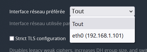

One thing that might explain the issue, is that under the “preferred network interface”, my tunnel interface is not listed. Even though it exists:
https://stuff.stooit.com/d/1/61d72a6eafbd3/2022-01-06_18-40.png

Could it be due to the /0 netmask? Anyway to force plex to pickup lo0?

Plex won’t allow you to select tun0 as the interface for local clients, either because of the name or because it’s a point-to-point interface. But you don’t want to, because it’s not a LAN interface and it’s got a /32 netmask.
You don’t want lo0, loopback interfaces can’t communicate outside of the local host.
Try setting Custom server access URLs to just http://10.42.0.21:32400. It’s a little bit funky but should do the right thing.
