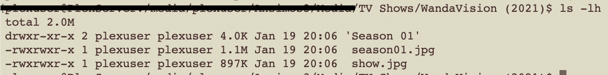

We’ll use WandaVision as an example. I have a show poster and a season poster. While it appears that the Show poster is detected as expected, the season is not. Here’s my setup (Ubuntu 20.04 server):
The season’s poster is currently the show’s selected poster. There should be a season poster available to select but its not there.
Here’s what I’ve tried:
  • Move Season-01-Poster.jpg to Season 01/poster.jpg and Season 01/Season01.jpg
    – Naming it poster.jpg under the season folder also makes it available as the show poster
  • Manually refresh metadata
  • Remove the show, empty trash, and readd show
I’ve read through several forum posts already but either those posts end up unanswered or are very specific bugs for platforms I’m not using. Any recommendations?

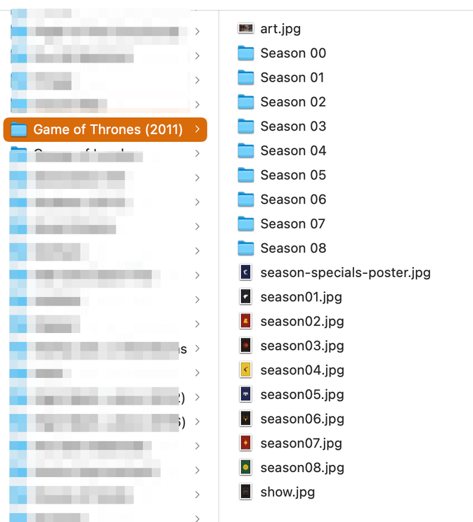

Name it season01.jpg https://support.plex.tv/articles/200220717-local-media-assets-tv-shows/#toc-1

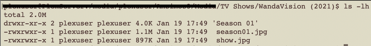

  1. Removed show from filesystem
  2. Emptied library trash
  3. Renamed file on different machine
  4. Readded show to server
  5. Updated permissions on image files to 775
  6. Refresh metadata in plex web app
Show poster shows up, season poster does not.
I’ve also tried the below with no avail…
WandaVision (2021)/
WandaVision (2021)/Season 01/

We’ve confirmed , not a bug on Linux – HOWEVER –
  1. They are placed how BigWheel states.
  2. Scan the files (to add the files)
  3. Analyze the series (to wake up the LMA so it associates them)
  4. Now Edit the show and select the poster.

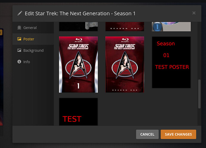

To confirm what I have so you have something to go by:
[chuck@lizum Star Trek The Next Generation.558]$ ls -la
total 52
drwsrwsrwx  9 chuck chuck  4096 Jan 19 21:12 ./
drwxr-xr-x 45 chuck chuck  4096 Jan 18 22:49 ../
drwsrwsrwx  2 chuck chuck  4096 Jan 19 20:50 Season 01/
-rw-rw-r--  1 chuck chuck 11575 Jan 19 20:45 season01.png

Thanks for the reference. This is what I currently have.

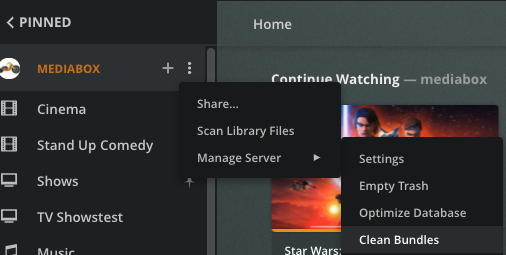

To confirm, you want me to remove everything inside Plex Media Server/plug-in support/caches/com.plexapp.agents.localmedia/HTTP.system ?
And I assume rerun the scan library + analyze steps?
yes. may want to clean bundles as well. ( in server menu)
Screen Shot 2021-01-19 at 6.41.30 PM
I deleted everything in the above cache, cleaned bundles via the Troubleshooting menu (I don’t have Clean Bundles in the Manage Server context menu in your screenshot). I then rescanned the library and analyzed the show. Still no poster in the season
